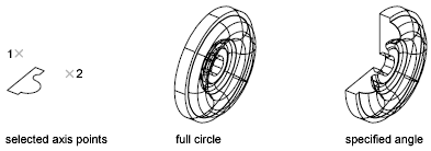

- Axis Start Point
Specifies the first point of the axis of revolution. The positive axis direction is from the first to the second point.
- Axis Endpoint
Sets the endpoint for the axis of revolution.
- Start Angle
Specifies an offset for the revolution from the plane of the object being revolved.
Drag your cursor to specify and preview the start angle of the object.
- Angle of Revolution
Specifies how far the selected object revolves about the axis.
A positive angle revolves the objects in a counterclockwise direction. A negative angle revolves the objects in a clockwise direction. You can also drag the cursor to specify and preview the angle of revolution.

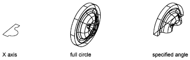

Note: Select an edge subobject by pressing Ctrl while you select an edge. - X (Axis)
Sets the positive X axis of the current UCS as the positive axis direction.
