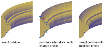

Swept Solids and Surfaces
Swept solids and surfaces display grips on the swept profile as well as on the sweep path. You can drag these grips to modify the solid or surface.
When you click and drag a grip on the profile, the changes are constrained to the plane of the profile curve.

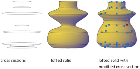

Lofted Solids and Surfaces
Depending on how a lofted solid or surface was created, the solid or surface displays grips on its defining lines or curves:
  • Cross section
  • Path
Drag grips on any of the defining lines or curves to modify the shape. If the object was lofted along a path, you can only edit the portion of the path that is between the first and last cross sections.
You cannot use grips to modify lofted solids or surfaces that are created with guide curves.

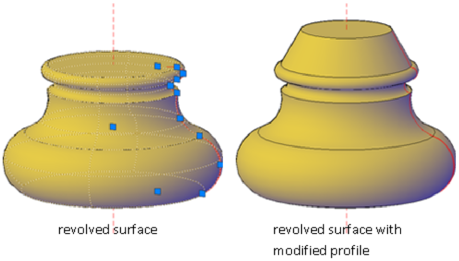

Revolved Solids and Surfaces
Revolved solids and surfaces display grips on the revolved profile at the start of the revolved solid or surface. You can use these grips to modify the profile of the solid of surface.
A grip is also displayed at the axis of revolution endpoint. You can relocate the axis of revolution by dragging the grip to another location.
