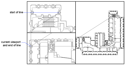

To Draw Across Two Model Space Viewports
In a large drawing, you can use this method to draw a line from a detail in one corner to a detail in a distant corner.
  1. Start the line in the current viewport.
  2. Make another viewport current by clicking within it, and then specify the second endpoint of the line.
