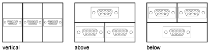

Split and Join Model Space Viewports
The illustrations below show several default model space viewport configurations.
You can easily modify model space viewports by splitting and joining them. If you want to join two viewports, they must share a common edge of the same length.
