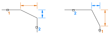

Create a Chamfer Defined by Two Distances
The size of the chamfer distance is defined by two length values. The length values define the first and second sides of the chamfer from the intersection of the two selected objects or adjacent 2D polyline segments.
- Click
- At the Command prompt, enter d (Distance).
- Enter a new first chamfer distance.
- Enter a new second chamfer distance.
- Enter e (mEthod) and then enter d (Distance).
- In the drawing area, select the first object or adjacent line segment in a 2D polyline.
Note: You can select a line, ray, or xline.
- Select the second object or an adjacent line segment in the 2D polyline.
Note: If the second line segment selected isn't adjacent to the first line segment, the line segments between the selected segments are removed and replaced with the chamfer.
