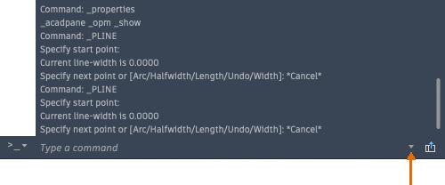

Use the Extended Command History
You can also display an extended command history without opening a separate window. Press F2, or use the control provided at the right end of the command line, to see the extended command history.
To copy all the text in the Command History to the Clipboard, right-click and select Copy History from the shortcut menu, or enter the COPYHIST command. To save commands automatically to a log file starting with the next command, enter the LOGFILEON command.
