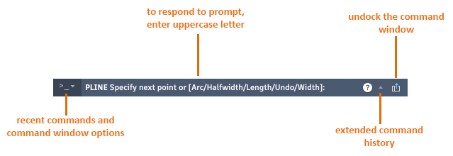

After you enter a command, you may see a series of prompts displayed at the command line. For example, after you enter PLINE and specify the first prompt, the following prompt is displayed:
PLINE Specify next point or [Arc/Halfwidth/Length/Undo/Width]:
In this case, the default is to specify the next point. You can either enter X,Y coordinate values or click a location in the drawing area.
To choose a different option, specify the option by entering the capitalized letter. You can enter uppercase or lowercase letters. For example, to choose the Width option, type w and press Enter.

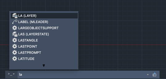

Aids for Entering Commands
The program offers several ways to remember which commands to use:
  • Automatic completion. Completes name of a command or system variable as you type it.
  • Command line suggestion list. Displays a list of commands or system variables that match or contain the letters you have typed. The program offers suggestions for misspelled entries.
  • Automatic correction. Commands that you frequently misspell. The program automatically adds words that you misspell and correct a specified number of times to the AutoCorrectUserDB.pgp file. You can also update this text file manually.
  • Command cycling. Cycles through commands you have already used in the current session when you press the Arrow keys. An arrow button on the left end of the command line also displays recent commands.
