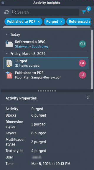

Below is a list of some of the activities logged and displayed on the Activity Insights palette:
Action Activity Insights tile
Saving an unnamed drawing New drawing created
Saving changes to a drawing Saved
Saving a version of the drawing stored within a supported cloud provider Version (version number)
Saving to a different file format Saved to different format

Drawing file cleanup Partial list of cleanup activities:
  • Purged
  • Audited
Activities Outside AutoCAD
There are some activities that occur outside of AutoCAD and AutoCAD LT that are included in the Activity Insights display. They can include the following:
  • Drawing renamed using Finder
  • Drawing copied using Finder
  • An older release of the product is used to make edits to the drawing
The user for these activities is shown as Unknown user on the Activity Insights palette.
