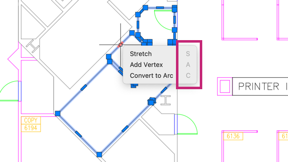

Polyline Grip Editing: Items on the dynamic menu displayed when you hover over a grip have been revised to make their functions easier to understand. Additionally, a new Lengthen option has been added to the dynamic menu for start and endpoint grips.
