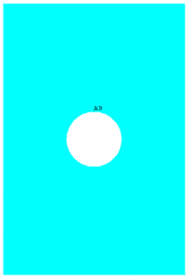

  11. Click OK in the Subtract Volumes dialog box. The plate geometry is now defined. The plate should appear as shown below.
    sketch
