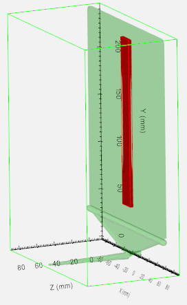

    Align Models
    1. Click Yes when prompted to use the interactive alignment tool.
    2. Enter 20 mm for TY and -38.1 mm for TZ and click Apply.
      align translation
    3. Use your mouse to rotate the model and make sure the two parts are aligned properly. Click OK.
      align models
