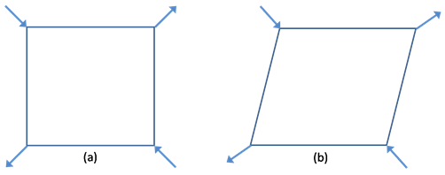

The simplest method of demonstrating the longitudinal shear stress/strain response of a composite material is to constrain and load a single element such that the longitudinal shear stress component is much greater than the remaining stress components. A state of pure shear stress can be obtained by loading an element as shown below.
pure shear

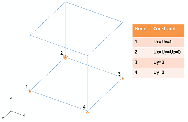

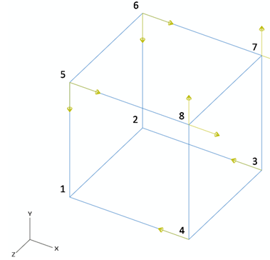

The nodal boundary conditions and loading shown below were used to obtain this loading in the finite element model used in this problem. The magnitudes of the loads shown below are identical.
boundary conditions
loads
