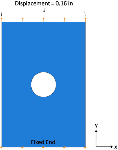

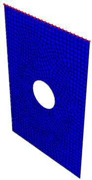

As an example, consider the 8-ply composite plate shown below. Note that this is the same composite plate problem examined in the previous section. Since this composite plate is subjected to a uniform axial displacement imposed along the top edge of the plate, the displacement will serve as an appropriate measure of the overall structural deformation of the plate. Similarly, the total axial reaction force along the top edge of the plate will serve as an appropriate measure of global structural force in the plate. This total reaction force is obtained by summing the nodal reaction forces for all of the nodes on the top edge of the plate (see second image below). The third image below shows a plot of global structural force vs. global structural deformation for the composite plate.
axial load fix
global forces fix

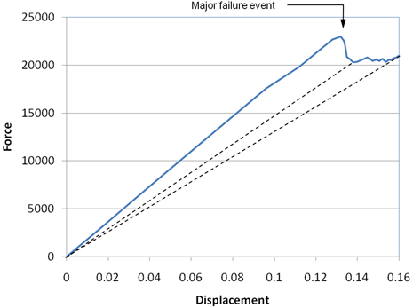

dplot fix
Beginning at an imposed displacement of 0.13, the overall secant stiffness of the structure starts to deteriorate rapidly. As the axial displacement is increased further, the structure is unable to resist the additional displacement with additional structural force.
Examination of the load-deflection plot reveals that the global force/displacement response of the composite structure appears to remain linear until the imposed displacement reaches a value of approximately 0.095. Interestingly, if we examine Part C of the contour plots in the previous section, we see that by the time the imposed axial displacement has reached the value of 0.08, the composite plate has accumulated a significant amount of matrix constituent failure along the vertical edges of the circular hole. However, this amount of matrix constituent failure is insufficient to make a visually detectable impact on the global stiffness of the composite plate. As the imposed displacement is increased from 0.095 to approximately 0.13, the global stiffness of the composite plate undergoes a visually detectable reduction in the load-displacement plot above; however, the structure is still able to respond to increasing displacement with increasing structural force.
In examining Part D of the contour plots in the previous section, we see that at an imposed displacement of 0.112, the composite plate has experienced a small amount of fiber constituent failure along the vertical edges of the circular hole. Note that this localized fiber constituent failure has not yet prevented the composite plate from responding to increased displacement with increased structural force. As the imposed displacement reaches approximately 0.133, the global stiffness of the composite plate exhibits a drastic reduction indicating a significant cascading of localized fiber constituent failures (i.e., a major failure event has occurred). As the imposed displacement is increased beyond 0.133, the composite plate no longer responds to increasing displacement with increasing structural force. Instead, the overall structural force in the composite plate remains relatively constant, indicating that the spread of localized failures is too rapid to build any additional structural force. However, as seen by the two dotted lines in the load-displacement plot above, the overall secant stiffness of the composite plate continues to decrease despite the fact that the overall structural force remains relatively constant.
