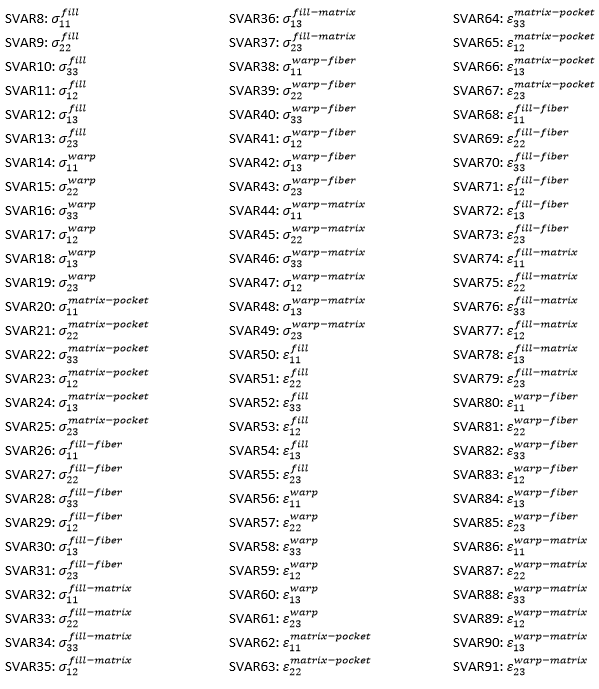

For woven composite materials, state variables SVAR2, SVAR3, ..., SVAR90 have the following interpretations for static progressive failure analyses:

For the case of woven composites, the remaining MCT state variables store the individual components of the average stress and strain states in the various superconstituents and constituents (e.g., fill = fill tow superconstituent, warp = warp tow superconstituent, matrix-pocket = matrix constituent of the intertow matrix pockets, fill-matrix = the matrix constituent of the fill tow, warp-matrix = the matrix constituent of the warp tow, fill-fiber = the fiber constituent of the fill tow, warp-fiber = the fiber constituent of the warp tow).
svar8 91
