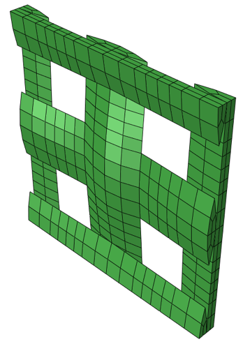

The plain woven composite micromechanics model consists of fill tows, warp tows, and a matrix pocket. The fill and warp tows are assumed to be perpendicular to each other. The unit cell chosen to model this type of microstructure was taken from Kuhn and Charalambides [1], and is shown below.
unit cell

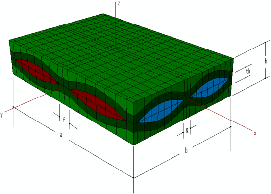

As seen above, there are many parameters required to completely describe the geometry of the unit cell. These include:
  1. The length of the unit cell
  2. The width of the unit cell
  3. The height of the total unit cell
  4. The height of the fill tows
  5. The height of the warp tows
  6. The spacing between the fill tows
  7. The spacing between the warp tows

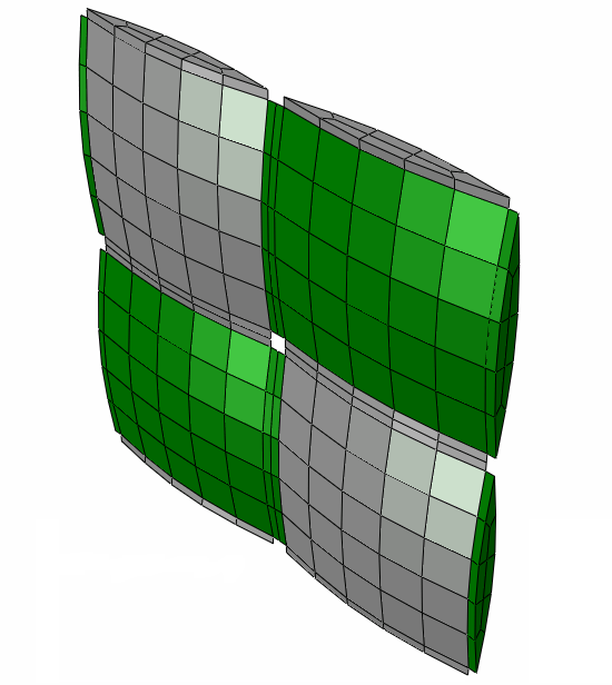

A view of the unit cell without the matrix pocket is shown below.
fill warp

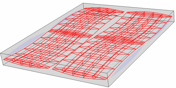

where BVFFill is the fill bundle volume fraction, BVFWarp is the warp bundle volume fraction, FVFFill is the fiber volume fraction of the fill tow, and FVFWarp is the fiber volume fraction of the warp tow. A bundle volume fraction is defined as the fraction of the volume the specified tow occupies compared to the entire composite. To present a more detailed discussion on bundle volume fractions and their meaning in the context of the geometry of the plain weave unit cell, consider the image below. The red highlighted region represents the volume the fill tows occupy in the entire composite unit cell. The fill bundle volume fraction is calculated as the volume of the fill tows divided by the volume of the composite.
bundle vol

Here we make a few assumptions about the geometry of the unit cell. First, we assume the fill and warp tow heights are equal, eliminating the dependency on both heights. The second assumption defines the total height of the unit cell and the height of the tows to be constant for any geometry specification. This effectively eliminates the third, fourth, and fifth dependency in the list above.
Finally, we assume the widths of the tows are equal and constant. Therefore, the width and length of the unit cell may be related to the spacing of the tows as:
a = width + 2f
b = width + 2g , (Eq. 2)
Therefore, only two unknown parameters are needed to completely describe the geometry of the unit cell; the spacing between the fill tows and the spacing between the warp tows. These parameters are directly related to the volume fractions of the fill and warp bundles, and to the number of undulations per unit length. Composite Material Manager uses bundle volume fractions (BVFs) to define the microstructure.
