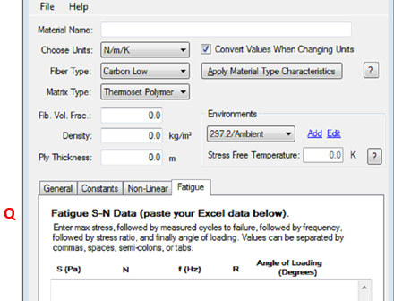

If the woven material being created is to be used in a fatigue analysis, fatigue data must be entered in the Fatigue tab.
fatigue tab
Q - Fatigue Data
This field contains experimental lamina fatigue data which are S-N data points. An S-N data point contains the following information:
  • S - the maximum lamina stress reached in a load cycle (the units of stress must be consistent with the unit set chosen)
  • N - the number of cycles to failure
  • f - the frequency of the loading in Hertz (cycles per second)
  • R - ratio of the minimum stress to the maximum stress
  • Angle of Loading - the angle of loading off from the axis of the fiber, in degrees
This data is used to optimize material fatigue constants used in a Helius PFA fatigue analysis. At least two data points are required to perform the optimization.

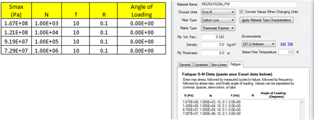

Suppose the data below is provided as experimentally measured fatigue data. This data would be entered into the GUI as shown below:
