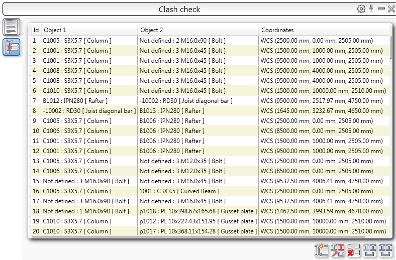

Displays the list of collisions in beams, plates, and bolts for an entire model or a selection set.
The collisions are numbered with continuous index numbers. For each collision, the involved elements and the coordinates referring to the world coordinate system are listed.
The List of Collisions
For each found collision, the following information is displayed:
- Index number.
- Part number of the first element involved in the collision: section size: model role.
- Part number of the second element involved in the collision: section size: model role.
- Coordinates of the center of the collision solid.
- Collision volume.

Double-clicking a line corresponding to a collision zooms directly to the collision solid.
