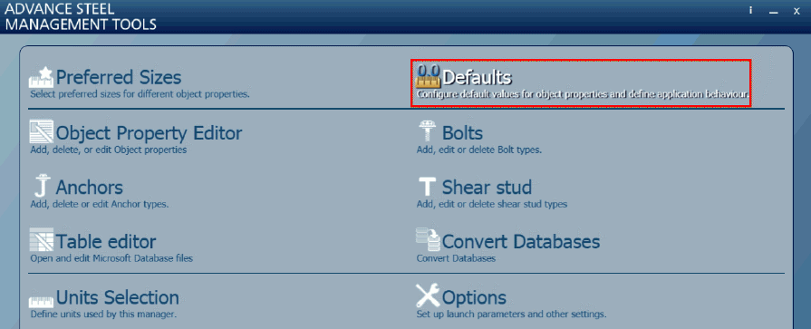

Any profile can be exported using the Export profile option, accessible from the Defaults category.

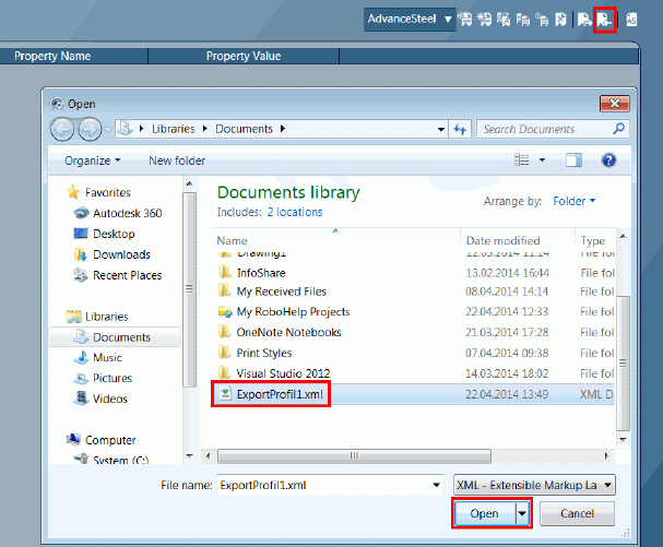

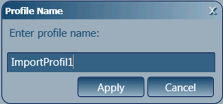

To import the new profile, the Import file option is used. The xml file is selected and the "Open" option is accessed, then the name of the imported profile is entered.

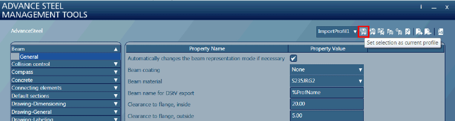

The new imported profile can be set as current using the Set selection as current profile command. After opening Advance Steel all defaults settings are available.
