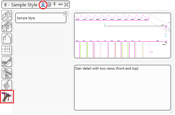

  9. Save and close the database, restart Advance Steel and open the Drawing Styles palette to see your new category.
    Note: Make sure you select the User category in the top right of the palette heading.
