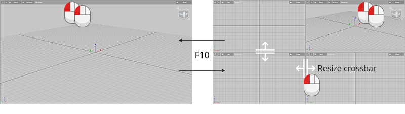

The model space can be viewed in single window or 'window pane', or in a multiple window arrangement such as Four Panes which is the default, and is similar to a traditional drawing board layout.
The layout can be switched between single and multiple view by either:
  • double-clicking on the window pane titlebar (where either Maximize or Minimize text is displayed, to the left of the Show menu).
  • using the Layouts > Maximize/Minimize Window command which has the default hotkey of F10.
  • using the Layouts > Four Panes command which has the default hotkey of F9.
When in a multiple window layout the crossbars can be used to resize the windows.

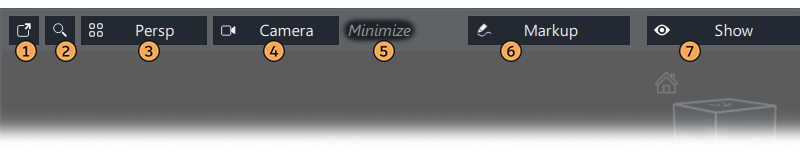

Window Pane titlebar
Each window pane has a titlebar with tools to manage the layout and views:
  1. Clone - Create a pop-out window that is a duplicate of the original.
  2. Magnify - Create a pop-out window with a 'zoom' area on the original window that can be used to focus on small parts of the model.
  3. Window Type menu - Choose between a perspective window and one of the orthogonal windows : Front, Back, Right, Left, Top, Bottom,
  4. Camera menu (Perspective window only) - Create new cameras or switch between cameras for different viewpoints.
  5. Maximize/Minimize - Double-click on the header bar to switch between a single window and a multiple window layout.
  6. Markup Lister - If Markups have been created, this lister will appear on the window header and can be used to switch between the views that the Markups have been made on.
  7. Show menu - Change the visibility of items in one or all view windows.
The transparency of the titlebar can be adjusted in General Preferences > Windows > Modeling windows > Titlebar Transparency. Increasing the transparency allows geometry to be seen behind the bar, but it cannot be selected in that area.

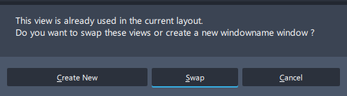

Changing Window Type
When displaying multiple windows (for example four views), if you switch to one that is currently on display you will get the following warning:
  • Create New - Creates a new view with an incremented name (e.g. Back#2) and adds it to the window type menu list.
  • Swap - swaps the views in the two panes.
  • Cancel - don't change the view.

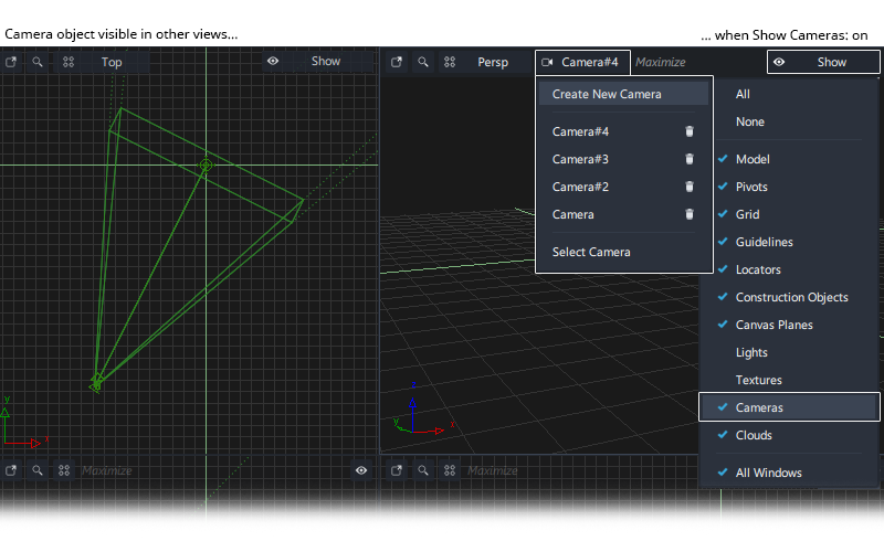

Camera menu
The Camera menu only appears when Window Type is Perspective.
A camera is an object in the scene that is used to view the model in 3D.
The camera object typically is not shown in the scene as Cameras are turned off in the Show menu by default. If you select Cameras on, they will only appear in windows where they are not being used to generate the 3D view.
Create New Camera
A new camera will be created and added to the list of cameras in the menu. The new camera will be then be selected for the perspective window current view. A new camera is created with the default Home viewpoint.
If you want to have more than one perspective window, from different angles, you will need to create an extra camera, and select it in the Camera menu.
Camera list
Select which camera to view in this window.
Use the trash can icon to delete a camera. A confirmation dialogue will appear as there is no undo function for deleting a camera.

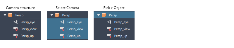

Select Camera
Picks (or unpicks) the current camera object in the scene. If one or more cameras or objects are already selected, the camera is added to that selection.
The components of the camera are selected, not the top group node. This selection will work if you want to move the camera, but will not give the correct results for a rotation. Use Pick > Object to work with the whole camera (top group node).
To see the camera object selected, make sure that Show > Cameras is on. Camera objects will be displayed in the orthographic windows. In the perspective window the camera currently being used for viewing will not be shown, but others will be.
Transforming a selected camera will affect the view in any perspective window that is using it, but the results can be unpredictable so is not recommended as a way of manipulating the view. Typically the only situation where you transform the camera as an object is when animating the view. See Alias Video Tutorials > Animate Cameras.
Note: To rename a camera, use the Visualization > Camera Editor.
Show menu
The Show menu appears on each view window titlebar. Click the Show button and select an item type to show it (check mark) or hide it (no check mark).
The drop-down list also has the following functions:
  • All - select all items to be visible
  • None - select all items to be hidden
  • All Windows - when on, apply the selection in the Show menu to all view windows. When off, then any changes will only apply to the view window where the Show menu selections have been modified.

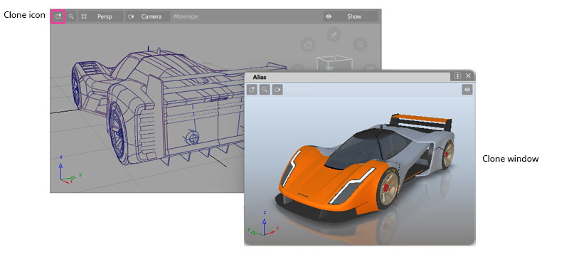

Clone view window
The clone icon creates a pop-out window that is independent of the Layouts menus arrangements, and always stays on top of the main windows.
This window can be placed on a second monitor, or used to display the model with alternative view settings:
  • If the Show Button is set to All Windows: off, then the cloned window can have different Show settings from the main windows.
  • If Hardware Shade is set to All Windows: Off, it will work independently between the cloned window and other layout windows.
  • To get a different viewpoint in a cloned perspective, create a new camera (see Window Type menu: Perspective Window Type and Camera menu above).
  • In an orthographic cloned window, turn Display > Window Sync off to be able to zoom and pan independently of the original window.

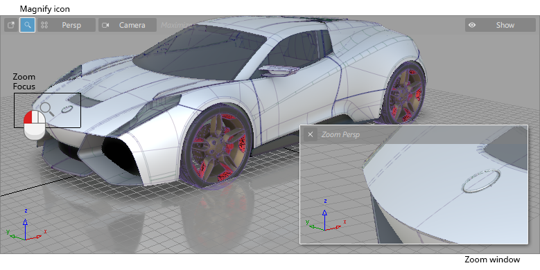

Magnify / Zoom view window
When you click the magnify icon in the window title bar, a 'zoom focus' box in the original window shows what part of the view is being magnified.
  • In the main view, drag the magnify handle at the center of the zoom focus box to move it.
  • In the magnify/zoom perspective window, use Shift + Alt + mouse buttons to zoom and pan the magnified area. The ViewCube is not available in the magnify window.
  • Click-drag on the edges or corners of the magnify window to resize it.
  • Click-drag on the header bar of the magnify window to move it.
  • Click on the X to close the magnify window.
