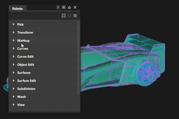

Markup palette
The Markup Tool Palette contains several simple drawing tools to create sketch annotations and drawings. Markups let you draw directly onto the camera view, making it easy to share feedback on design projects.
Access the Markup brushes from the Markup tool palette:
When using a Markup brush, if no markup is currently active, it creates one on the current view. Rotate the view to exit the active Markup when you are finished drawing. Markups are automatically saved and can be accessed in the Markup Lister.

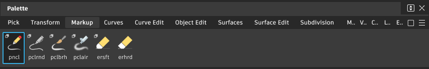

Markup brushes
The Markup tool palette provides the following brushes:
Pencil
Applies pencil strokes to the active Markup.
Pen
Applies a uniform pen stroke to the active Markup.
Brush
Applies a tapered brush stroke to the active Markup.
Air Brush
Applies air brush strokes to the active Markup.
Soft Eraser
Erases the stroke from the active Markup using a soft edge.
Hard Eraser
Erases the stroke from the active Markup using a hard edge.

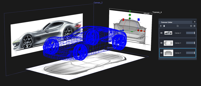

Images as Canvas
Images can be imported as a canvas which lets you place and transform them as planes. This is useful for setting up reference images that need to exist in the scene.
Import through file menu
- Select File > Import > Canvas.
- Choose an image using the file browser.
- The image is placed facing the camera and can now be transformed.
Import through Canvas Lister
- Open the Canvas Lister by choosing in Window > Canvas Lister.
- Click the
icon to open the file browser and choose an image. - The image is placed facing the camera and can now be transformed.
