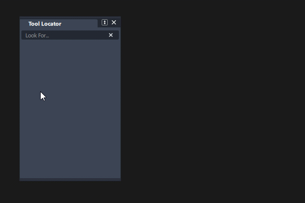

Tool Locator
Finds tools or menu items in the interface that match your search phrase. Type part of the name of the tool or menu item you want to find. You can use regular expression matching.
As you begin typing, the Tool Locator window automatically populates with results based on your query, narrowing the search as you type more of the tool name. Select the tool icon or menu item from the Tool Locator to activate that tool or open the menu item.

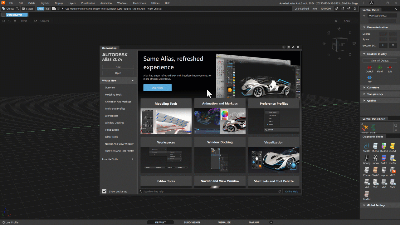

Onboarding
Opens the Onboarding window, which provides information on what's new and demonstrates essential skills for both new and experienced users to get started in Alias right away.
See the highlights of What's New in this version of Alias, and click the Learn More button for additional information in the online help.
Learn essential skills by watching the tutorial videos in the Essential Skills section, and click the Learn More button to visit the online help page for more details. You can also watch the videos online with subtitles by clicking the Watch Online links.
You can create a new empty wire file or open an existing one directly from the onboarding window. Click Recent to quickly access to your recent files. Display them in list view for file details or switch to grid view to see larger file previews, and select a file to continue working where you left off.

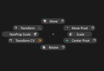

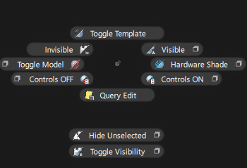

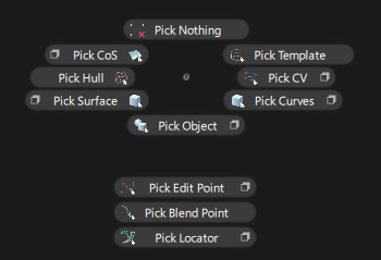

Marking menus
Hold Shift + Ctrl and press one of the mouse buttons.
Ctrl + Shift +
Ctrl + Shift +
Ctrl + Shift +
Picking
