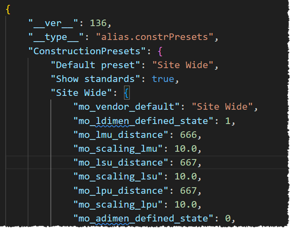

Note the following flags in the file:
  • "Default preset": "Site Wide", - Indicates which preset is loaded by default when Alias starts.
  • "Show standards": true, - When set to true, the standard default presets display in preset list of the Construction Options window. When set to false only the presets in the file and those defined by the user display in the list.
