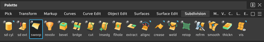

Access the tool from the Subdivision Palette:

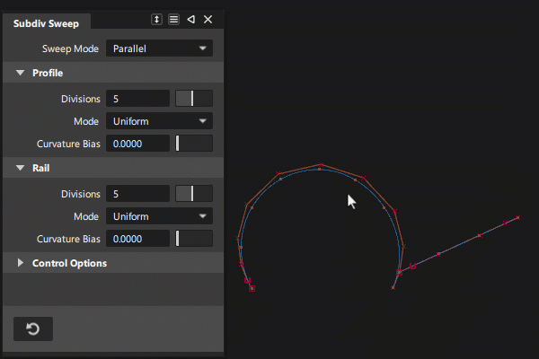

Subdiv Sweep settings
Sweep Mode
- Parallel - As the generation curve sweeps along the rail, it maintains its original orientation.
- Radial - As the generation curve sweeps along the rail, it pivots to maintain the same angle relative to the rail curve.
Profile/Rail
Sets the properties of the resulting geometry along the profile and rail curves.
Divisions
Sets the number of segments along the length of the curves.
Mode
Uniform - Distributes the CVs evenly along the length of the curves. When you select this mode, you can use Curvature Bias to adjust the how curvature affects the distribution. For example, you can add Curvature Bias to distribute more of the CVs to areas with greater curvature.
Parametric - Uses the parametric space to distribute the CVs. For example, CVs are positioned based on the U parameter value along the source curve.
Curvature Bias
(Available only for Uniform Mode) When set to 0, the CVs are evenly distributed. As you increase this value, the profile curve curvature has a greater effect on how the CVs get distributed.
