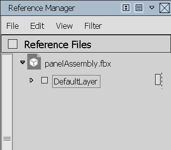

Reference Manager additions
You can now pick several layers and change their color at the same time just like you can in the Object Lister
FBX files can now be imported as references files.

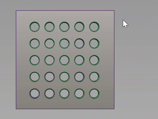

Surface Fillet Tool
We've added a third selection color to surface fillet inputs to indicate when more than two sets of surfaces have been picked. Now, when you select a third input set, the picked surfaces display in white. This way, it's easier for you to modify the selection to create two sets, or confirm the creation of multiple fillets. Use the selection options to add or remove surfaces from the individual sets.
In previous versions of Alias, multiple input sets displayed in the secondary surface color (yellow), which made it difficult to distinguish between second and third input sets.

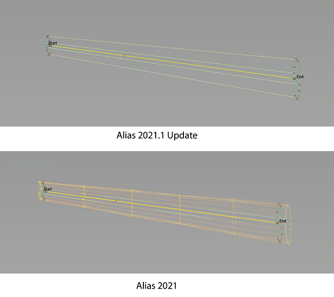

We've improved the Profile Tool so that it now highlights the input profile curves correctly in situations where they do not touch the rail.

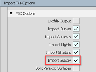

You can now use the FBX file format to load and save subdivision bodies. Subdivision material assignments are supported.
Note: Creases are not supported when transferring subdivision bodies between Alias 2021.1 and Maya 2020 or Maya 2018 using the FBX format. In Fusion 360, subdivision bodies import as a mesh with a subdivision cage.
See FBX import options and FBX export options.

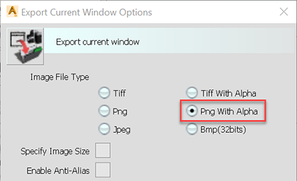

When using File > Export > Screen or File > Export > Current Window, you can now output the PNG file with or without alpha information.
