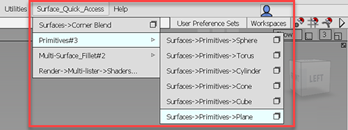

New custom menu
You can now create a custom menu to provide quick access to your commonly used modeling tools and menu options. Any tool, menu command, or plug-in that can be added to a custom shelf can also be added to the custom menu. After creating a custom menu, it displays in the Alias main menu between the Utilities and Help menus. Use a custom menu to combine the tools and commands you routinely use to help streamline your workflow.
For more information see Create a custom menu.

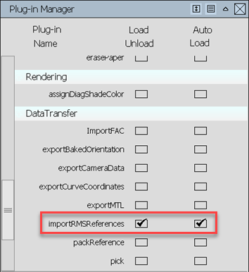

Reference Manager additions
A new ImportRMSReference plug-in lets you import Reference Manager Session (RMS) files directly into the Reference Manager. RMS files are used by Dassault Systèmes® ICEM Surf™ to save an assembly. Note that .kddat and .icem files are not supported by the plug-in.
You can access the ImportRMSReference plug-in from the Alias Plug-in Manager (Utilities > Plug-in Manager). After the plug-in is loaded, use File > Import > Import RMS References to import RMS files to the Reference Manager.
You can then load the reference data by selecting File > Update All in the Reference Manager menu.
We've also provided the ImportRMSReference plug-in as an example plug-in. You can access it in the OpenAlias\examples folder of your Alias installation directory. For example: C:\Program Files\Autodesk\AliasAutoStudio2021.3\ODS\OpenAlias\examples\ImportRMS.cpp.
For more information, see Reference Data plug-in example.

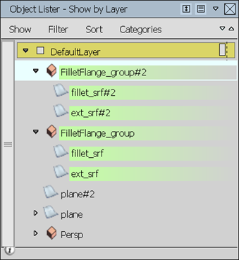

Fillet Flange tool
We've improved the way that Fillet Flange outputs are grouped in the Object Lister. A fillet surface and its flange extension are now grouped together under a parent group. When you want to modify or delete both fillet and flange, you just select the fillet flange group. In previous releases, the fillet and flange extensions were stored in different groups.

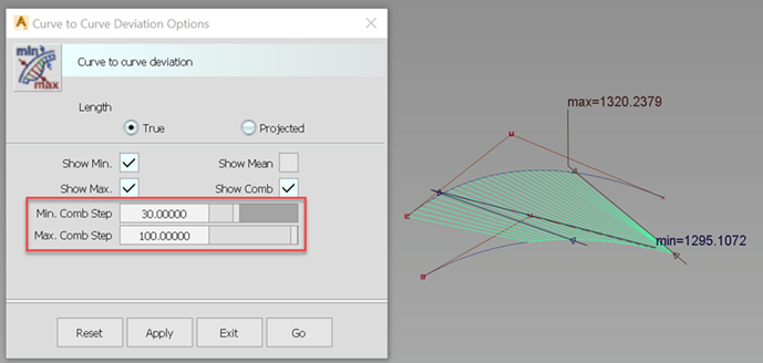

Deviation tools
We've made some changes to the Curve to Curve, Surface to Surface, Curve to Surface, and Mesh to Surface Deviation tools. The updates include the following:
- You can now change the Comb Step value directly in the Information Window independently of the Min Comb Step value in the tool control window.
- We've renamed Max Comb Density to Min Comb Step to be consistent with the Information Window. This value still controls the minimum increment size of the comb samples.
- We've added a new Max Comb Step option for controlling the maximum increment size of the comb samples. Note that the Min Comb Step and Max Comb Step controls set the range when adjusting the comb step value in-canvas using the MMB and RMB.
