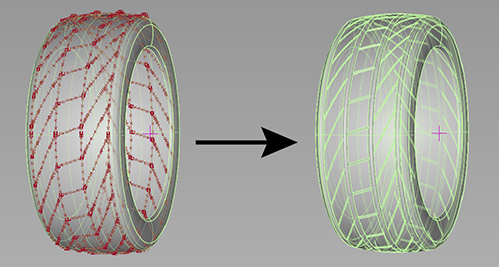

The DP-Nurbs-Tire.dyn
- We've added a Show Curve Preview option, which lets you preview the pattern of a tread before generating it. This way, you can quickly view changes to your tread design and make any required adjustments before generating the tread geometry. Also, you can now generate multiple tires with the script.

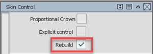

New Rebuild added to the Skin tool
We've added a new Rebuild option to the Skin tool. When turned on, the CV distribution on the skin surface is rebuilt so that it matches the CVs distribution of the first input curve you selected. Use Rebuild to remove unnecessary multi-knots or additional CVs that appear in the skin surface.
Renamed Match Parameterization to Rebuild
