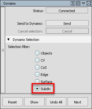

Dynamo now supports the exchange of subdivision bodies. Use the new Subdiv selection filter to begin sending subdivision bodies to Dynamo.

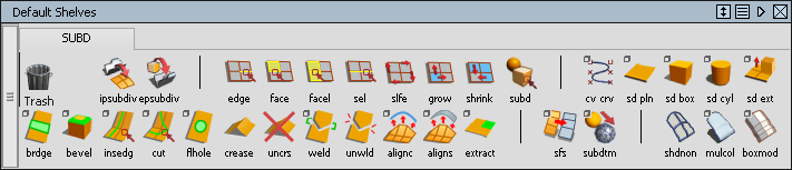

We've created a custom shelf for the Subdivision modeling tools. The shelf brings all the subdivision-related tools together for easier access. Download it from the Alias Sample Files web page. To load it, choose Replace shelf set from the
menu on the Shelves window title bar, and browse to the downloaded SUB.scm file. See Manage shelves for more information about custom shelves.

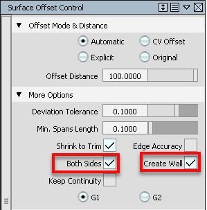

Surface Offset and Curve Offset improvements

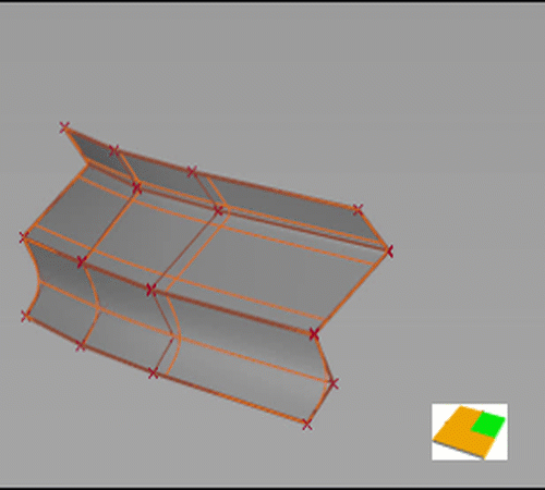

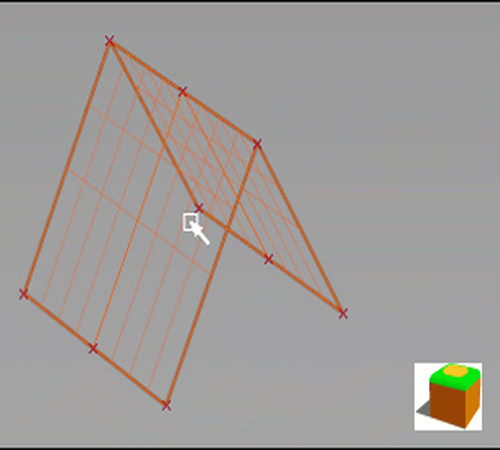

A new Create Wall option lets you create closed geometry from an offset surface and the original surface. This option joins the free edges of offset surfaces to edges of the original surface. If Both Sides is on, creating two offset surfaces (top and bottom), the edges of these surfaces join to create the closed geometry, instead of the original surface. In the Object Lister, the wall geometry appears under the Offset Wall sub-group.
We added a Both Sides option, which lets you create an offset surface or curve on both sides of the original surface and respective curve. Offset settings value apply to both offset surfaces or curves.
Shrink to Trim now checks to determine if any trimmed surface can be converted into a natural surfaces, and then applies a Trim Convert operation.

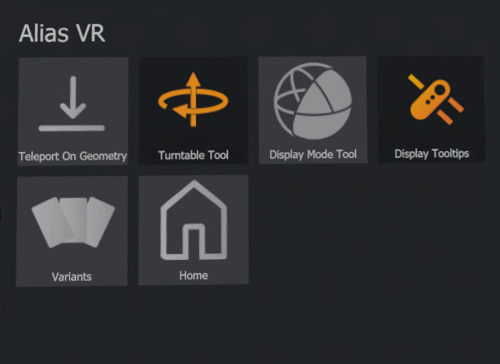

View in VR (previously Alias VR) enhancements
We renamed Alias VR to View in VR and moved access to the feature from the WindowDisplay menu to the new VR menu. To access it, select VR > View in VR.

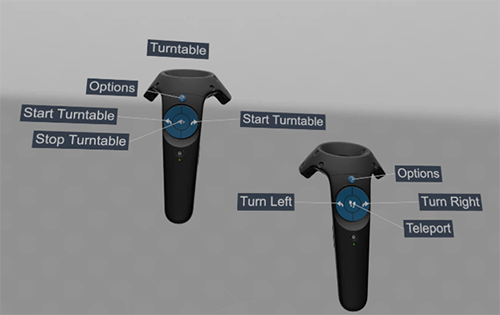

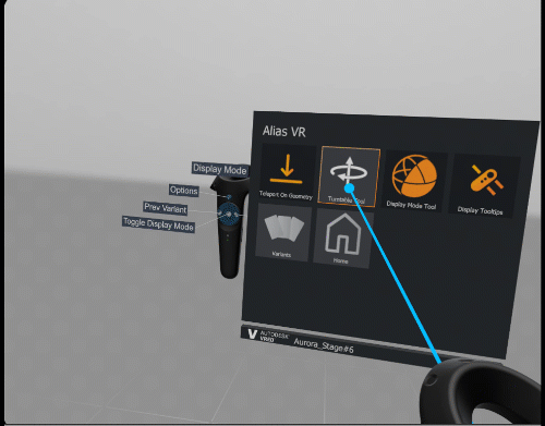

We added a new menu to the VR environment. The menu provides access to all the previous View in VR features, such as Display Modes, as well as to new features, including the Turntable Tool. To access the menu, press the Options button on either controller. Select menu items by pulling the controller trigger.
See Work with View in VR.

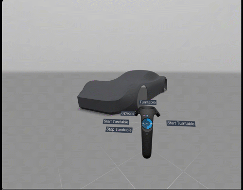

A new Turntable Tool lets you view models as they rotate 360 degrees around a pivot point. You can rotate objects clockwise or counter-clockwise direction as well as choose the rotation speed of turntable.
View and switch between variants using the new Variant menu in the VR environment. You can still switch between variants by using the VR controller. A Height options in the VR Variants lister lets you make adjustments to the Z value for instances when a camera variant is configured to show a model's interior. This means you no longer need to add '_ int' to the end of the variant name to force a camera variant's Z value.
Variants in VIew in VR now support material, object and layer visibility switching in addition to previously support camera changes. This means that the camera, shading, geometry, and layer visibility masks you applied to variants in Alias are respected when viewing variants in View in VR.
We've updated the fly-out tooltips on the VR controllers to include all the new and previous tools. These labels dynamically update as you switch between active tools.

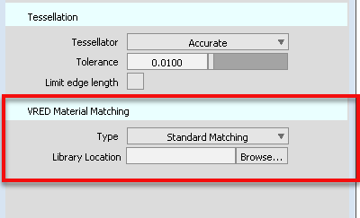

A new VRED Material Matching feature for View in VR ensures that material assignments in View in VR and VRED look the same. Use this option to specify material asset libraries that use a schema for matching VRED material assets to Alias shaders.

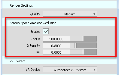

Screen Space Ambient Occlusion settings are now exposed, letting you further improve the image quality of your models in View in VR.

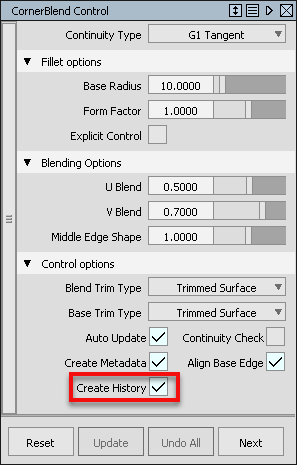

We added the Create History option to the control window of several surface and multi-surface editing tools. You can now toggle construction history on and off for these tools.
For more information, see About construction history and Work with construction history.

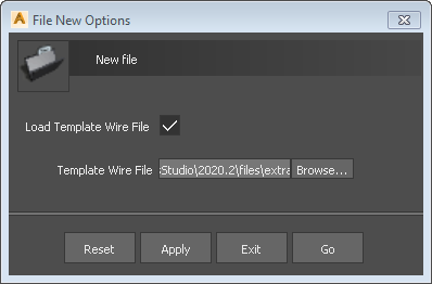

You can now specify a custom WIRE file as the default when you creates a new scene. This means that you can open a new file with all of you commonly used elements such as shaders and lighting without needing to import them each time you start a new scene.

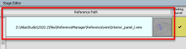

A new Reference Path option in the Stage Editor lets you choose to show the path of file currently open on the stage instead of the stage name.

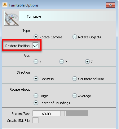

The Turntable now includes a Restore Position option for camera rotation. This lets you choose to stop an animation at its current position or at its start-frame position.

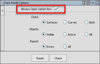

A new Always Open Option Box option has been added to the Check Model tool. When on, the Check Model Options window opens when you activate the tool. This is useful if you access the Check Model tool using a hotkey, and want to configure the Check Model options before running the check. When this option is off, Alias runs the model check when the tool is activated.
