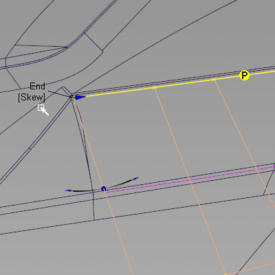

  • We added in-canvas context menus to several tools, such as the Align, Skin, and Free Form Blend tools. To access these menus, right-click the manipulator text.

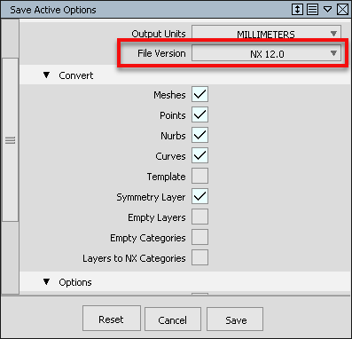

  • You can now save (File > Save As > NX) or export (File > Export) files to the NX version 12 file format.

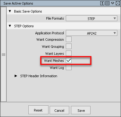

  • A new Want Meshes option lets you save Alias objects as meshes when exporting them to the STEP AP242 file format.
