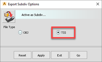

Added T-spline support to Subdiv Export
You can now export subdivision bodies (File > Export > Active as Subdiv) to T-splines TSS files. The T-spline file format maintains crease information and can be imported in other Autodesk products such as Dynamo, Fusion, and Speedform.

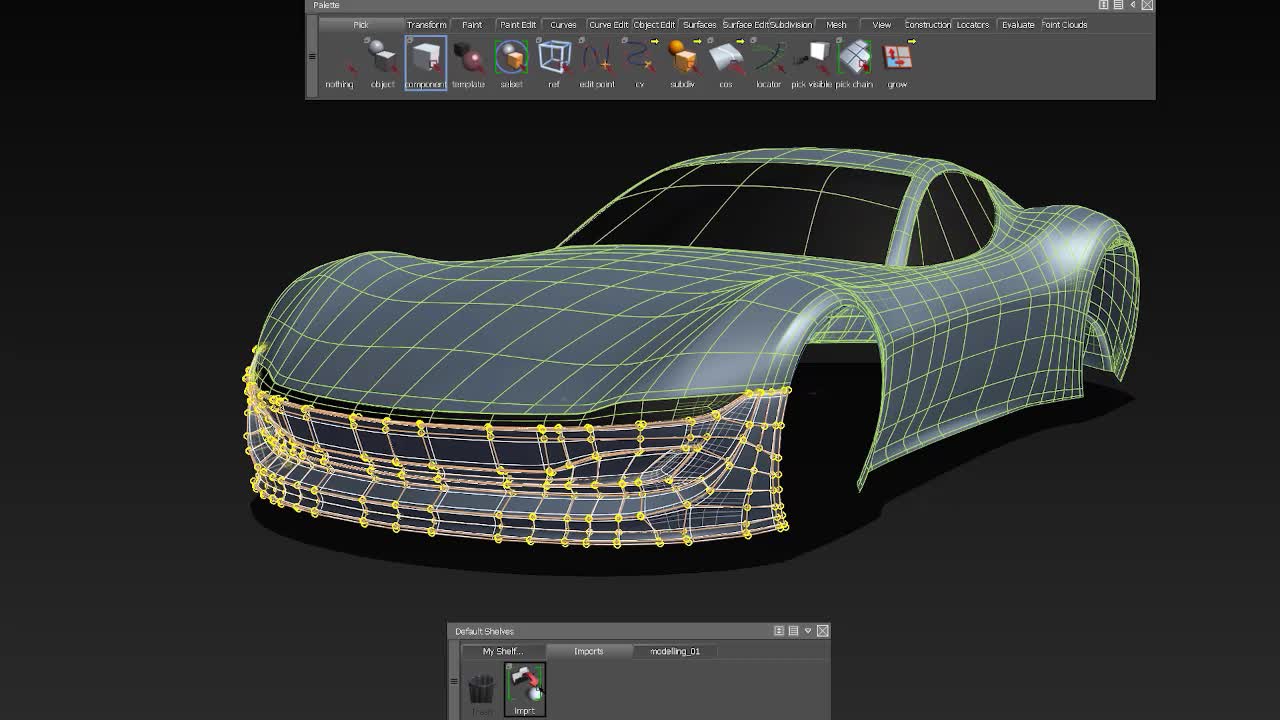

File import improvements and additions
- When using File > Import, Alias now retains the last directory location that was accessed. This means that you can add File > Import commands to your Shelf as way a to quickly access frequently used import locations.
