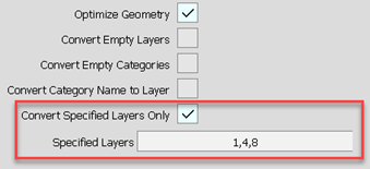

NX file import additions
Convert Specified Layers Only
We've added a new Convert Specified Layers Only NX import option so that you specify which layers in an NX file to open in Alias. After enabling this option, type the designated numbers of the target layers in the Specified Layer field. To do this, you can use a comma separated list, a layer number range, or a combination of both. The valid layer number range is between 1 and 256.
If you are using the NXToAlias command line utility, enable the Convert Specified Layers Only option with the -layerSelect flag. Specify the target layer numbers in a string contained by quotations, such as the following: -layerSelect "1,4,6";.
Optimize Geometry
A new Optimize Geometry option optimizes the CV layouts of the imported file for use in Alias.
If you are using the NXToAlias command line utility, you can enable this option by setting a new optimize geometry flag (-g)
See NX Import options and NXToAlias.
