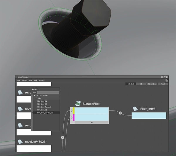

Introducing History Presets
Alias 2022 introduces History Presets, which provide a way to save and reuse Alias tool settings in the History Visualizer. Presets save the construction history of existing tool nodes, which you can then apply to other tool nodes of the same type. Using presets lets you quickly and consistently regenerate commonly used geometry. Sharing presets across a network not only helps your design team to increase workflow efficiency, but also they can help maintain surface modeling standards across teams.
For more information, see the following topics:
We've also added a new Pan With MMB option, which lets you navigate history graphs by holding down the middle-mouse button and dragging. You can turn on Pan With MMB in the History Visualizer View menu.

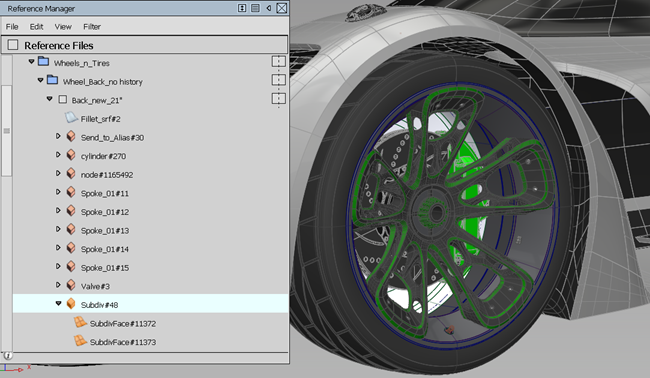

Support for group nodes
In 2022, we've continued to improve the way reference data is represented in the Reference Manager so that it more closely resembles the way source data displays in the Object Lister. For example, group nodes now display in the Reference Manager. When you import references that include group nodes, the group hierarchy now displays exactly the way it does in the Object Lister. Also, reference objects that come from subdivision bodies now display in the Reference Manager with the same subdivision objects icons used by the Object Lister.
To complement the support of group nodes in references, we've added the following:
  • When you pick a reference group, Assign Shader applies the shader to all surfaces, meshes, and shells in the group.
  • A Pick Level option in the Pick Reference tool called Object, which now picks the root node of a group when you select a reference object in the canvas.
  • A filter option for Groups, so you can choose to display or hide group nodes in the Reference Manager.

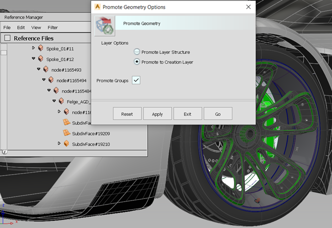

New Promote Geometry options
We've improved the Promote Geometry feature to give you more control over how your reference geometry gets promoted. A new Promote to Create Layer options lets you promote the geometry as a flat hierarchy without creating unwanted layers. With this promotion method, you can choose to preserve the group node hierarchy of the reference by turning on Promote Group. To preserve the layer hierarchy, including existing layers, layer folders, and group nodes, of your referenced files, use the new Promote Layer Structure option when promoting geometry. This option produces results similar to the way Promote Geometry worked in previous releases.
Use the method when promoting the geometry of nested reference hierarchies as it generates all the geometry for the entire structure, including top-level nodes down to child nodes.
For more information, see Promote reference data.

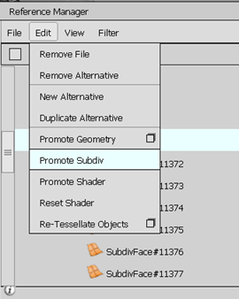

Promote Subdiv
A new Promote Subdiv option lets you promote referenced subdivision objects to subdivision geometry. Promoted subdivision geometry includes the object's faces and the control cage as well as any crease information. All subdivision objects in your selection get promoted to geometry. For example, if you select a file, all the referenced subdivision objects get promoted, and if you select a layer or group, objects in the layer or group get promoted.

  • A new Reset Shader option lets you restore the source geometry's shader to its referenced object. You can access Reset Shader in the Reference Manager Edit menu.

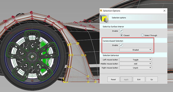

New Camera-based Selection option
We've added a camera-based selection option to Alias, so you can now choose to only select components with a clear line-of-sight to the camera. This ensures that you do not accidentally select components you cannot see. Camera-based selection has Shaded and Shaded & Wireframe Controls options so that, whether you are working with shaded objects or objects in wireframe, you can use a camera-based selection method that best suits your workflow. You can assign a hotkey to Camera-based selection to quickly toggle it on and off as needed.

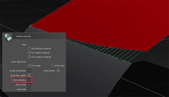

  • We've added a deviation comb for the G0 Positional Continuity locator. To display the comb, turn on the Show deviation in the Surface Continuity Options window. You can use the left mouse button to scale the comb and the middle mouse button to edit the steps in the comb.

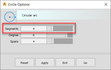

  • You can now create segments for Keypoint Circles. After creating the circle, open the Information Window (Windows > Information > Information Window), and in the Attributes section, enter the Arc Length/Radius values for each segment.

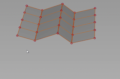

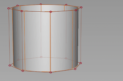

New Torus primitive
We've added a new Subdivision Torus Tool for creating torus primitives.
See Subdivision > Primitives > Subdiv Box/Plane/Cylinder/Torus.
