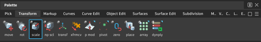

Access this tool from the Transform palette:
Scale objects proportionally
- Select the Scale tool
. - Drag to scale the object uniformly along all axes, or type a scaling value.
