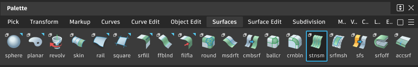

Access this tool from the Surfaces palette:

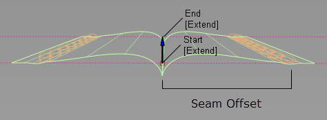

Seam Offset
The distance from the seam to the stitches.
For Join type seams (which do not have top-stitching), the stitch surfaces do not extend past this offset distance.

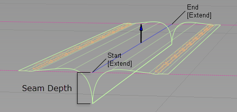

Seam Depth
The distance from the curve-on-surface to the seam.

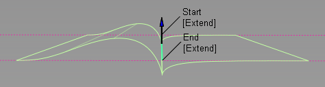

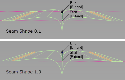

Seam Shape
The shape or curvature of the seam surface at the seam. Smaller values give a tighter seam, larger values a more open seam.

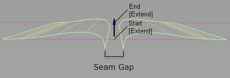

Seam Gap
The space between the surfaces at the seam.

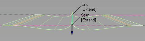

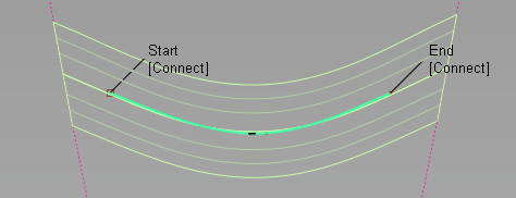

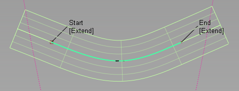

Start/End
Controls how the edges of the seam surfaces meet the edges of the surfaces on which they are created.
Default – The end edges of the seam surfaces remain perpendicular to the curve-on-surface.
Extend – The seam surface end edges are extended so that they reach the surface edges while remaining perpendicular to the curve-on-surface.
Connect – The seam surface end edges meet the surface edges exactly.
Edge Align – The tool tries to align the seam surface end edges with the edges of the surface.

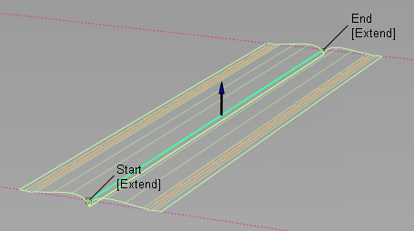

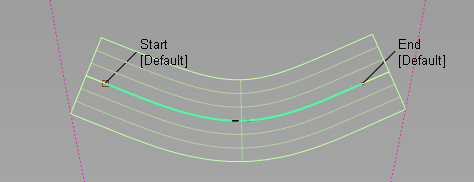

Modify Range
When this option is selected, Start and End sliders appear in the control window, and arrow manipulators appear on the selected curve-on-surface. Drag these arrows to modify the extent of the seam along the curve-on-surface.
Start/End
Use these sliders to modify the extent of seam along the curve-on-surface. Start and End values of 0.0 and 1.0 respectively, define the original extent.

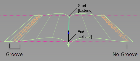

Groove
Create Groove
For French seams only. Create an indent along the stitching line of one or both sides of the seam. Increase the Groove Size for a wider indent along the stitch line.
Decreasing the Groove Size may decrease the Stitch Diameter and could also result in a seam that appears to have no stitches. Increasing the Groove Size does not automatically increase the Stitch Diameter.

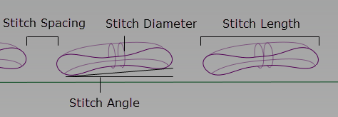

Stitches
Create Stitch
For French and Baseball seams only. Create stitches on one or both sides of the seam.

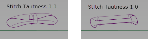

Stitch Tautness
Changes the shape of the geometry to represent stitches that are pulled tight. As tautness increases, the stitch profile becomes flatter and more elliptical.

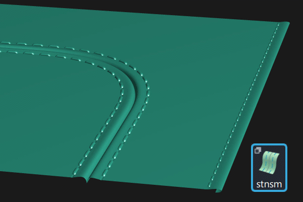

Create a seam and stitch geometry
Automate the creation of seams and stitching for visualization. Using a curve-on-surface to define the seam line, use the Stitch and Seam tool to create seam and stitch geometry.
