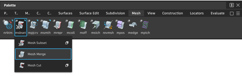

Access this tool from the Mesh tool palette:

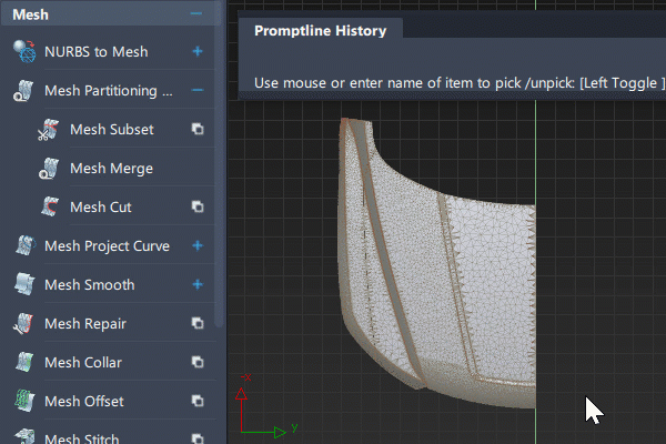

Merge meshes workflow
Select the tool.
Select two or more meshes.
Press the Merge button in the lower right corner of the window.
The selected meshes are combined into a single mesh object.
