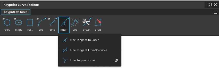

Line Tangent
Lets you create a keypoint line tangent. There are three Keypoint Line Tangent tools: Line Tangent to Curve, Line Tangent from/to Curve, and Line Perpendicular:

Access this tool from the Keypoint Curve Toolbox:

Keypoint Line Tangent tool workflows
Draw a line tangent to a curve
  1. Click the Line Tangent to Curve tool .
  2. Click the start point of the tangent line.
  3. Click the curve you want the line to be tangent to.
