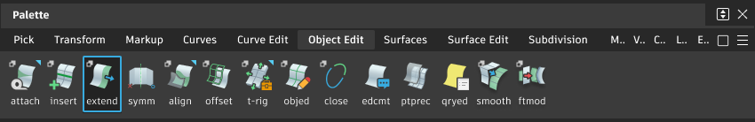

Access this tool from the Object Edit tool palette:

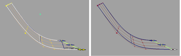

Extend a curve or surface by extrapolating its shape
Select the Extend tool
.Click near the endpoint of a curve, curve on surface, or an edge of a surface.

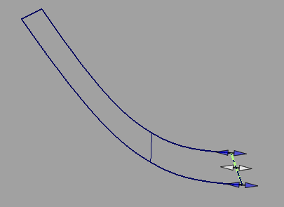

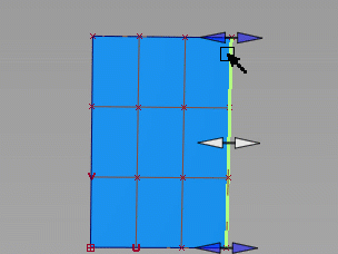

A double arrowhead manipulator (for curves) or thick green border with three double arrowhead manipulators (for surfaces) indicates which end or edge will be extended.
Note: You can select and extend several curves, curves-on-surface or edges simultaneously. The only restriction is that all selected objects must be of the same type.
Do one of the following:
- For a curve, drag the mouse to change the extend length.

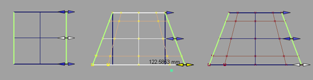

- For a surface, select the middle manipulator and drag to extend the surface proportionally. Or select one of the outer manipulators and drag to extend the surface non-proportionally.
- Instead of dragging, you can type a distance and press 'Enter'. The distance is measured either in the current linear units, or as a percentage, depending on the Measurement setting in the Extend Object Options window.
Note: Both ends must be extended in the same direction, either positive or negative. A label shows the extension distance while you’re dragging. The controls are turned on until you exit the tool.Note: You can only extend periodic surfaces proportionally (one manipulator).If using the Extrapolate type with Merge on, you can select two opposite edges of a surface and symmetrically extend both at the same time, as shown below.
In all other cases, you can only use non-proportional Extend when a single edge is selected. Consequently it will not work when Chain Select is on and several tangent continuous edges are selected automatically.
