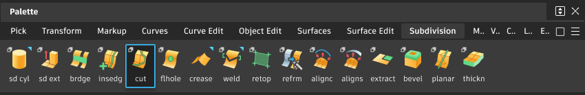

Access the tool from the Subdivision Palette:

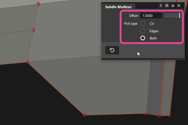

Subdiv Multicut settings
Offset
Specifies the distance along an edge to place the cut in the set working units. You can set this value using the slider, by LMB-dragging, or by input into the promptline.
Pick Type
- CV - Cuts and rebuilds edges along the path of selected CVs.
- Edges - Cuts and rebuilds edges at selected locations along edges.
- Both - Cuts the surface along the path of selected CVs or at specified locations along edges. This is the default setting.
