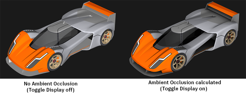

Ambient Occlusion generates shadows, which adds definition to shapes and generates areas of contrast to your hardware shaded models making them appear more life-like.
The effect is created by calculating shading based on a theoretical ambient light source to create general areas of shadow on your model. This information is saved to the .wire file, and after it has been calculated, it can easily be turned on and off without requiring a large overhead of calculations again by selecting Ambient Occlusion > Toggle Display.

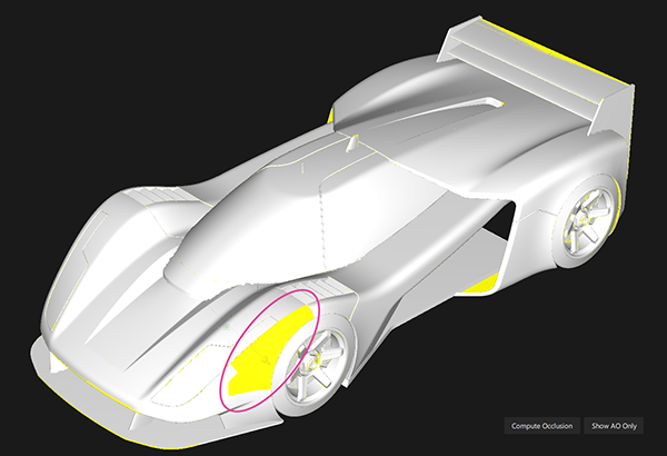

    After clicking Go, the model or surfaces display in Orientation Mode. In this mode, you can check and correct any normal orientation problems. Ambient occlusion requires that all surface normals are unified or facing the same direction.
    missing
    Surfaces with correct normal orientation, which is facing out, display white. Surfaces that have incorrect normal orientation display yellow.
  2. Left-click the yellow surfaces to correct the normal orientation.
  3. Click Compute Occlusion. The calculation can take up to a minute.

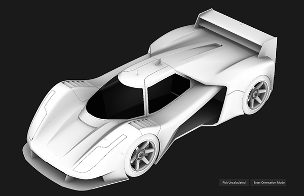

    After the calculation, you see baked shadows on your model that add more contrast in hidden areas.
    You can also now toggle between Orientation Mode and the calculated ambient occlusion display clicking the Enter Orientation Mode and Show AO Only buttons.

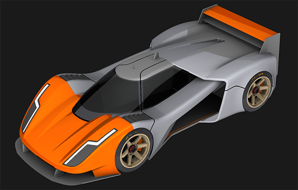

  4. To return the model to Hardware Shade display, choose Pick Nothing then Pick Object.

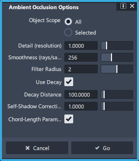

Ambient Occlusion Options
Object Scope
Choose whether all surfaces are to have their occlusion textures calculated (All), or only the picked (active) surfaces in the scene (Selected).

Detail (resolution)
Occlusion texture resolutions are computed automatically in order to balance the quality evenly across the model and provide a reasonable resolution for models of any scale. The Detail slider lets you scale these resolutions up or down.
Increase this value to ensure that small details are calculated and included in the ambient occlusion. If the scene does not have small details, the number can be left low.

Smoothness (rays/sample)
Increase this value if your image is speckled or spotty to create a smoother, more uniform image.
The value is the number of rays traced per pixel of occlusion texture. A higher value takes longer to compute but reduces the contrast of the noisyness of the resulting texture.
The algorithm used for the smoothness calculation rounds the number of rays to a multiple of 4, so try to use a multple of 4 for this value.
Filter Radius
Controls the smoothing of occlusion textures.The slider range is 1-4, however, you can enter values in the range of 0 to 7.

Use Decay
Activates a distance limit for objects occluding a point on the surface to be shaded. Objects further than this distance (Decay Distance) will have no effect on the Ambient Occlusion of the surface at that sample point.
Decay Distance
The distance (in scene units) from a sample point at which objects no longer occlude the sample point.
Self-Shadow Correction
In the event that a surface is both sufficiently concave and very coarsely tessellated, you might see some black spots or streaks in the model. Usually, the problem can be solved by computing occlusion with Hardware Shade set to a finer tessellation than before. If it still has spots and streaks, the Self Shadow Correction value can be increased, and those surfaces recomputed to fix the artifact.
Self-shadowing can be confirmed as the cause of an artifact by turning on Show Triangles in the Hardware Shade settings and observing whether the dark spots line up with the tesselation grid.
Chord-Length Parameterization
Causes the surfaces to use a mapping technique that ignores the UV parameterization of the spline-based surface, and instead maps according to surface distances (measured in world space units). This can help to distribute occlusion detail evenly over surfaces regardless of how they are constructed. Seam artifacts are sometimes produced because of highly uneven detail distribution.
