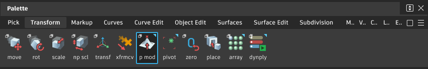

Access this tool from the Transform tool palette:
Proportional Mod Control settings
