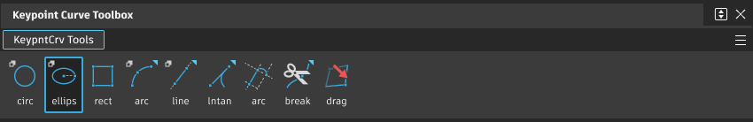

Lets you create a keypoint ellipse by drawing the two major axis points, or by drawing a center point and a major axis point.
Access this tool from the Keypoint Curve Toolbox:
