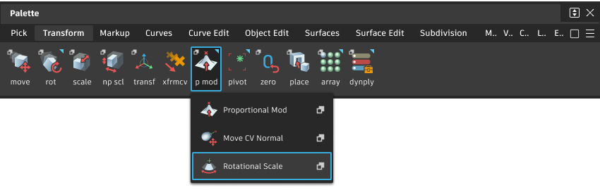

Access this tool from the Transform tool palette:
