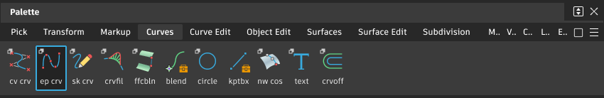

Access this tool from the Curves tool palette:
