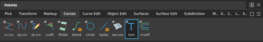

Lets you create and manipulate text in the viewport. The Text tool uses your system fonts.
Access this tool from the Curves tool palette:

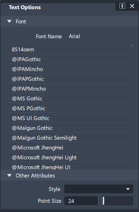

Shift click the Text tool to open the option box.
Click the name of a font in the scrolling list.
Click in a view window and begin typing.
