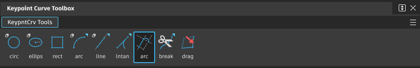

Allows you to create a series of alternating keypoint lines and arcs.
Access this tool from the Keypoint Curve Toolbox:
