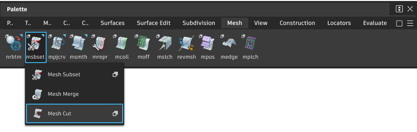

Access this tool from the Mesh tool palette:

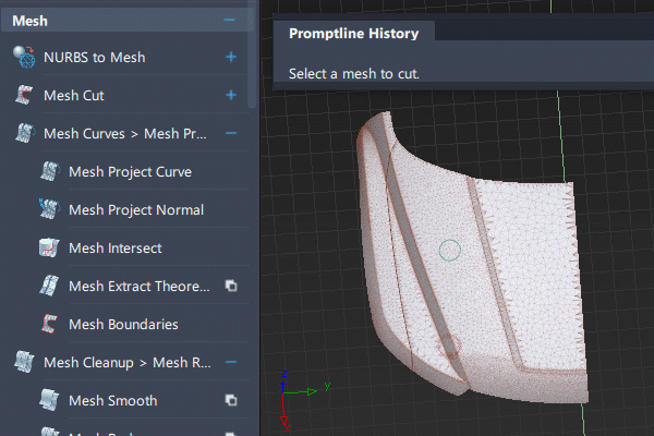

Cut a mesh along projected curves
Select the Mesh Cut tool
.Follow the tool’s prompts to select the mesh and projected curve(s). (The curves must still have their construction history intact.)
Click the Cut button in the lower right corner of the window.

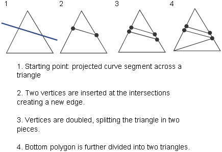

Triangles along the projected curves boundaries are split to create the individual components (see diagram below).

Note: Once the mesh is partitioned, the split triangles cannot be fused back together to become one single triangle again, even after the logical surfaces are joined to create one mesh using the Mesh Merge tool
