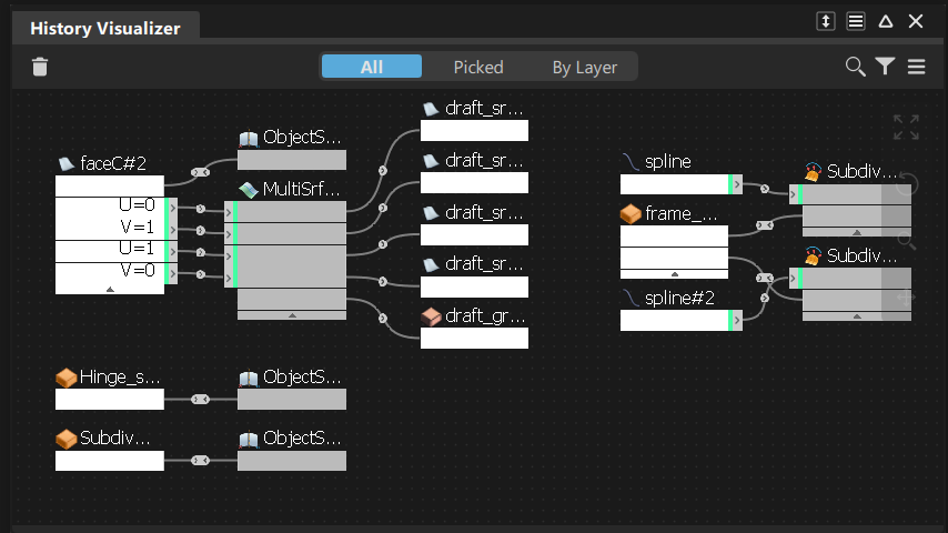

History Visualizer
Opens the History Visualizer, which displays the construction history of objects in your scene as a node graph of connected input geometry, tool commands, and output nodes.
Input geometry, tools, and the output of tool commands display in the graph area as a series of connected nodes. Construction history flows left to right from the input geometry nodes along the connections to the tool nodes, and then to the output nodes resulting from commands.
See Construction history and metadata for information about construction history.

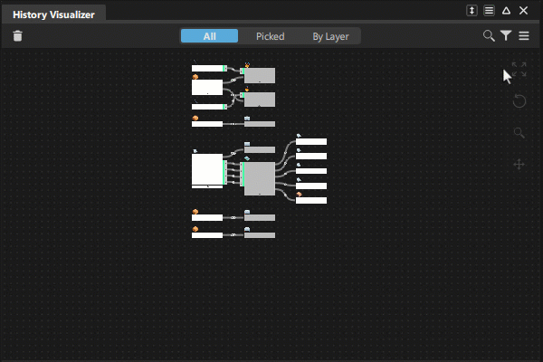

- Fit Window - Adjusts the width of the graph view so that all node connections from left to right get displayed. Depending on the complexity of the history graph, some nodes may not be visible (also available in the More menu).

Working in the graph window

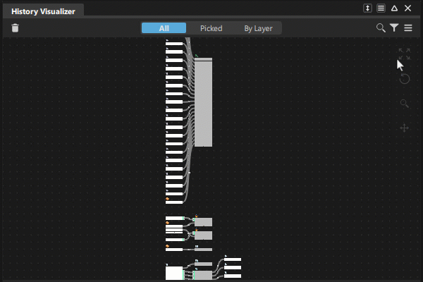

By default, the History Visualizer displays a graph view of the construction history for all the objects in the file. Only objects with construction history appear in the graph.
Ways of viewing objects with history
Use the All, Picked, and By Layer buttons at the top of the graph window to focus view.
Navigating in the graph
Use the tools on the right side of the graph window to navigate inside the window.
Selecting and moving nodes
- Click a node to select it, or box-select nodes, than drag to move them in the graph.
- To move a tool node and its connected input and output nodes as a group, click the tool node, and then press Ctrl and drag.
When selecting nodes in the graph, note that:
- Input nodes: Highlights the node and its connections to the tool node. The input geometry is picked in the viewport.
- Tool nodes: Outlines the connected input and output nodes. The object created by the tool operation is picked in the viewport
- Alt + click a tool node: Centers the viewport on the objects. This works similar to the Look At tool.

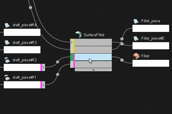

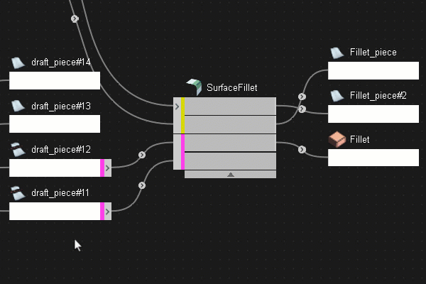

- Collapse an individual input or tool node - Click the triangle icon (
) below it. When collapsed a node's input and output connections display with a single connection and the nodes are labeled with Multiple connections. - Collapse all the tool nodes, select Collapse All from the More menu.
- Expand all collapsed tool nodes, select Expand All from the More menu.
- Group output nodes from a given tool to a single node, select Compress Outputs from the More menu.

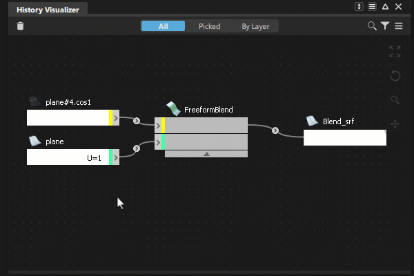

Workflow: Modify history by replacing inputs
You can modify the construction history of an object by substituting the connected input nodes of geometry with other geometry in the scene. The promptline assists you in selecting valid input geometry to make the replacement.
Replace a single input
Do one of the following:
- Right-click the input node port on the tool node and select Replace from the context menu.
- In the viewport, select the replacement geometry.
Or
- Right-click the input node and select Replace from the context menu.

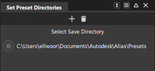

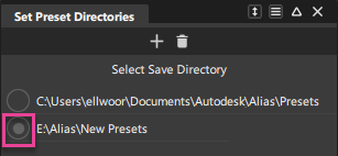

Set file locations for presets
Before creating history presets, you can set a file location to store them. By default, Alias automatically creates a Preset directory in the C:\Users\username\Autodesk\Alias folder.
Initially, all presets you create are saved to this default preset directory.
You can add more local or network file locations as preset directories, and set one of these directories as the designated location for saving presets. You can apply presets from any directory you add as preset directory.
To add a file location as preset directory, select Presets > Set Preset Directories from the More menu.
Click the Add Directory
icon, and then browse to the location you want to set as a preset directory.To set it as the designated preset directory, click to the left of the new file location.
All new presets will be saved to this location.
To remove a preset directory, either right-click and select Remove. Or, select it, and then click the Remove Selected icon

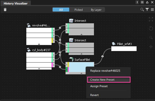

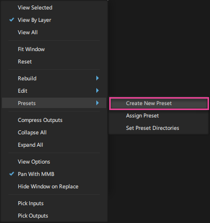

Creating history presets
In the history graph, locate the tool node with the history you want to save as a preset.
Tip: Use the graph view filter options to quickly locate the tool node you want to create presets from. For example, you can filter the graph view by tool node type so that it focuses on only the tool nodes you specify.Do one of the following:

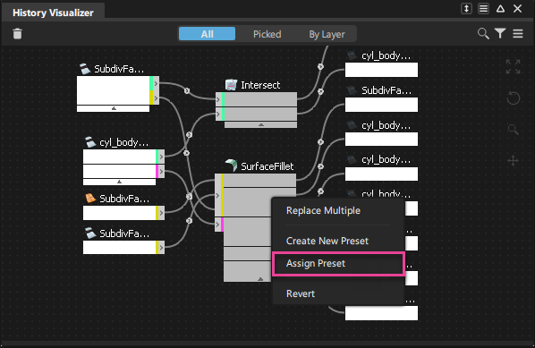

- Right-click the node and select Create New Preset from the context menu.
- Choose Presets > Create New Preset from the More menu.
Type a name for the preset and click save.
Your preset is saved as a
.hprestfile in the designated preset directory. By default, the designated directory is located here:C:\Users\username\Autodesk\Alias\Presets.

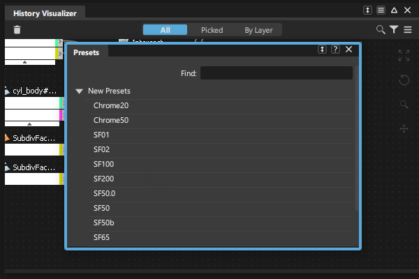

Assign a history preset
In the history graph, locate the tool node to which you want to assign a history preset.

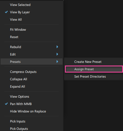

- Right-click the node and select Assign Preset from the context menu.
- Choose Presets > Assign Preset from the More menu.
The Presets window displaying the presets contained in the designated directory.
Tip: Use the Find field to quickly find a preset. As you begin typing, the Preset list automatically populates with results based on your query.Select a preset to apply.
