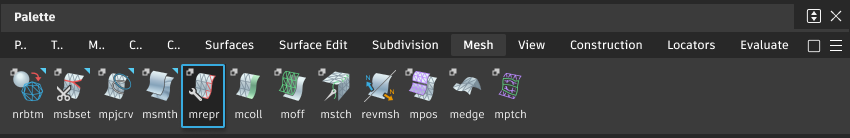

Access this tool from the Mesh tool palette:

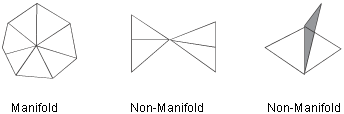

Manifold: Occurs when no vertex is adjacent to more than two boundary edges, and no edge is shared by more than two triangles.

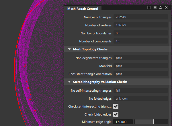

Mesh Repair Control settings
Mesh Information
Number of triangles/Number of vertices/Number of boundaries/Number of components
Non-editable fields that display information about the selected mesh.
Mesh Topology Checks
Theses checks must pass in order for other mesh tools to operate on the model.
Non-degenerate triangles/Manifold/Consistent triangle orientation
Non-editable fields that display the result of the sequential tests as pass or fail.
Non-degenerate triangles – Test passes if there are no duplicate or degenerate triangles. Also tests presence of duplicate and overlapping triangles. This happens when the same three vertices describe two triangles. This condition can be identified during test by an arrow pointing to the center of the triangles.
Manifold – Test passes if there are no non-manifold vertices.
Consistent triangle orientation – Test passes if the normals of all the triangles have the same orientation.
Stereolithography Validation Checks
Theses checks are only required to create a dataset that can be used in stereolithography processing.
No self-intersecting triangles
Test passes if the mesh does not intersect itself.
No folded edges
Test passes if the angle between any pair of triangles is more than the Minimum edge angle value.
Check self-intersecting triangles
If this option is checked, the self-intersecting triangles test is executed.
Check folded edges
If this option is checked, the folded edges test is executed.
Minimum edge angle
Specifies the minimum angle allowed between the planes of two triangles sharing an edge. If the angle is smaller than this value, the triangle is considered as having “folded over”. The default is 15.0 degrees.
This option is only available when Check folded edges is turned on.

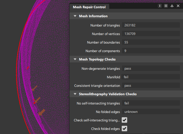

Red arrows appear, pointing to problems with the mesh, if any. The promptline describes what type of problem the arrows represent. The control window displays mesh information (statistics) and whether or not the mesh satisfies the criteria (passes the tests) defined above. These criteria are examined, and related problems are fixed, one at a time.
If a test fails, click the Repair button in the lower right corner of the modeling window to start fixing the mesh.
Clicking the button more than once may be necessary. Alternatively, click the Repair All button to fix everything in one step.
Follow the instructions on the promptline and keep clicking the Repair button to successively correct the different problems with the mesh.
Once the process terminates, the mesh boundaries are drawn in red.

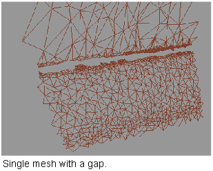

In the Mesh tool palette, click the Mesh Stitch tool
to seal gaps between the boundaries of components in a mesh. This tool works best to eliminate narrow gaps between boundaries. To fill larger openings, in the Mesh tool palette, select Mesh Cleanup, then click the Mesh Hole Fill tool
.Build small “bridges” across gaps within a mesh, so that Mesh Hole Fill
can be used to fill up the remaining holes.
