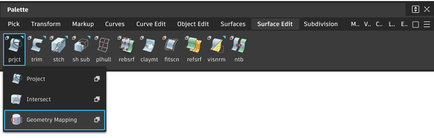

Maps world-space curves onto the target surface, similar to mapping a texture onto a surface during rendering.
Access this tool from the Surface Edit tool palette:

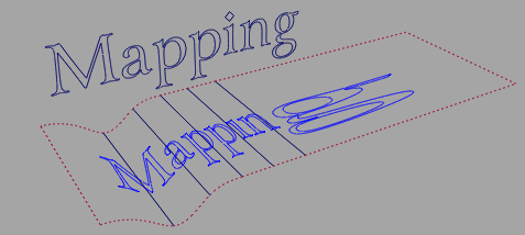

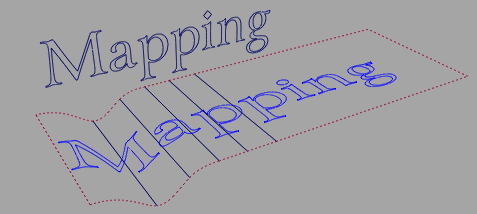

  • Parameter Base – Proportionally map the defined area of world space to the parameter space of the surface. If the surface has irregular placement of edit points, as in the following example, the mapped geometry is distorted.
  • Arc Length Base – Proportionally map the defined area of world space to the arc length of the surface.
