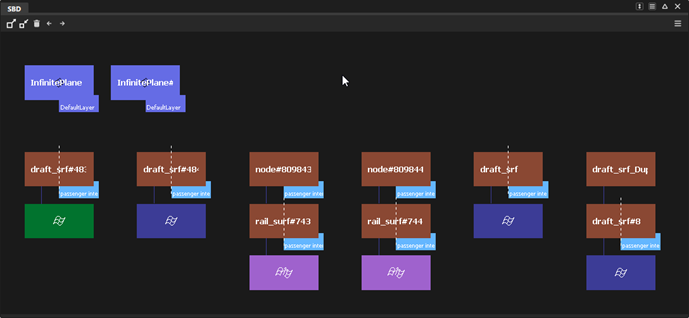

Shows or hides the SBD window, which lets you view the internal structure of objects and groups in the scene. The SBD window is like a view window, except instead of showing a visual representation of your scene, it shows a graph of the internal structure of the scene in the computer.
Alias keeps track of every aspect of the scene in a data structure equivalent to a graph. Curves, surfaces, groupings, transformations, components, lights, and everything else in the scene is represented by nodes in the graph. This graph is called the Scene Block Diagram.
Nodes in the graph (sometimes called DAG nodes) represent the “main” objects in the scene: curves, surfaces, curves on surface, lights, locators, and so on. Many things you can manipulate in the view windows, such as CVs, do not have their own DAG nodes. They are stored as part of an object’s internal information.

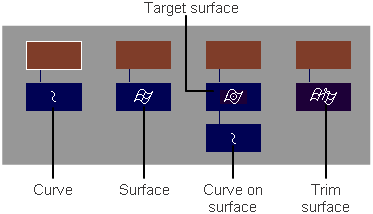

Types of nodes
Positioning node – The brown positioning nodes contain the transformations applied to the geometry nodes below it in the graph.
Geometry node – The blue geometry nodes contain the internal structure of a piece of geometry (edit points, CVs, and so on).
Different types of geometry are indicated by different icons in the blocks.
